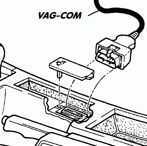

DLC located under the shiftboot in the center console.

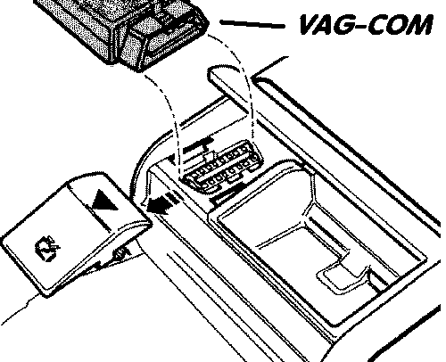

DLC located in the center console to the
right of the ashtray.

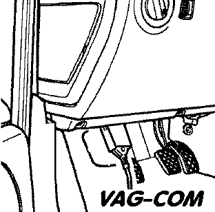

DLC located below the dashboard near the hood release.

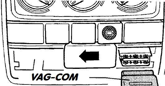

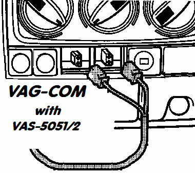

DLC located behind panel in
dash.

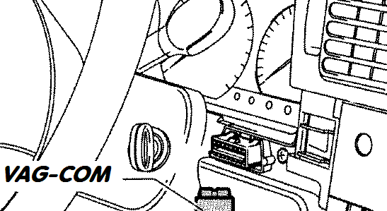

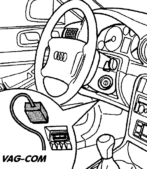

DLC located behind a panel to
the right of the steering column.

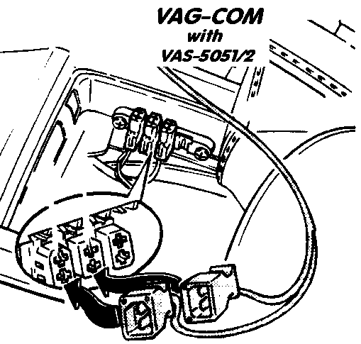

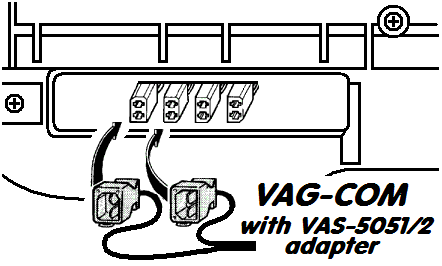

DLC located in fuse box under
hood near firewall.
