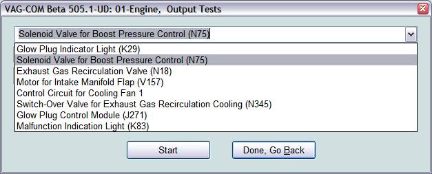

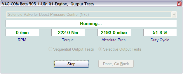

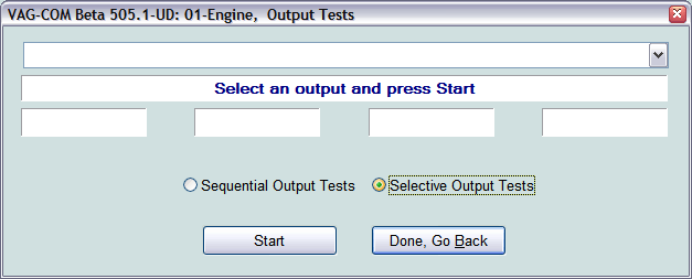

  • Selective Output Tests.   On those modules which support it, this is a more sophisticated version of the traditional (sequential) Output Test function.   It allows the user to select a particular output and activate it directly without going through a pre-defined sequence to get there.   Some modules have outputs which can only be tested this way.   Selective Output tests requires supporting data in a label file.   There is no way to efficiently query a control module to find out which outputs this are supported.

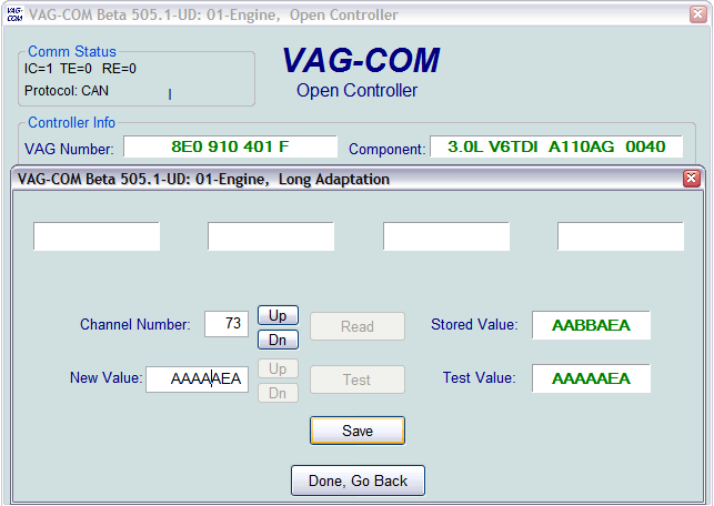

  • Long Adaptations.  Used/needed (for example) to balance the fuel injectors on Common-Rail TDI engines such as the BKN.

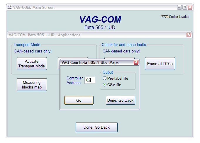

  • Measuring Blocks "Map" function.  Accessible via Applications Menu.   Rapidly scans through all 255 possible measuring block groups on any ECU and writes a "map" file.   Output is your choice of .CSV  or .PLB ("Prototype Label, Blocks").   Useful for creating label files and taking a "snapshot" of all available data from an ECU.

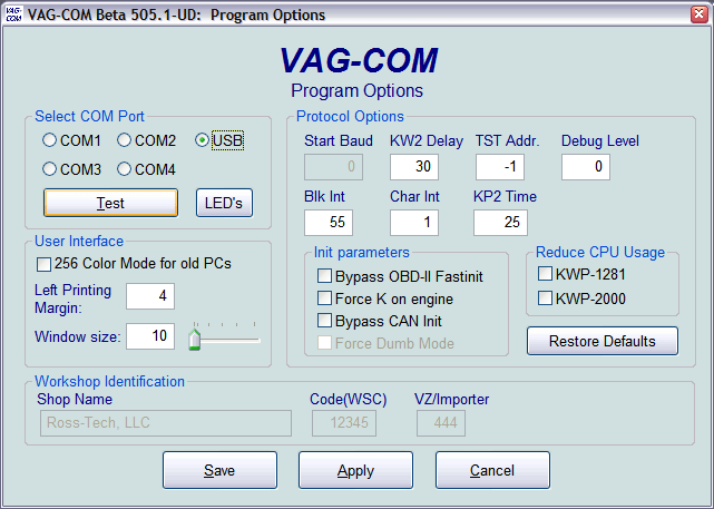

  • Revised Options Screen with parameters grouped more logically:

  • The ability to manually enter an Index when coding Airbag modules in case where VAG-COM would offer coding suggestions but cannot determine the Index automatically.

  • Fixed problem with 'C' key clearing the New Value field when performing Long (alphanumeric) Adaptations.    This problem was a result of our too-faithful VAG-1551/1552 keypad emulation where 'C' clears input fields.
  • The Bypass CAN Init checkbox on the Options screen now applies to generic OBD-II sessions as well as native VAG.
