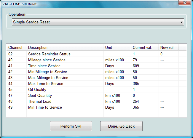

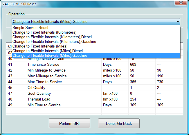

Service Reminder Function.
Accessible via the Applications screen. Gives an
overview of all SRI-relevant Adaptation channels:
New values can be entered by hand, or the user can select from a
number of functions which will load standard value sets.
Upon clicking [ Perform SRI ] the new values will be stored
in the (often less than intuitive) sequence required.
Note: The Service Reminder Function requires supporting data in Label
files. Beta 702 ships with a fairly comprehensive set,
but we doubt we've managed to cover every possible car.
If you encounter a car for on which the SRI function is not
accessible, please send us a
map of the
adaptation channels from the instrument cluster in that car.

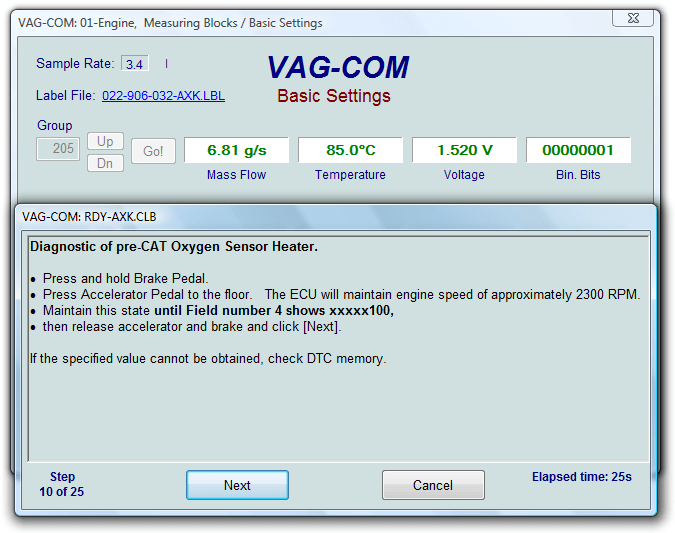

Support for Guided Readiness Scripts.
Accessible from the Readiness screen, this function will guide
the user through the process of setting Readiness on those engines
which support it.
Note: The Guided Readiness Scripts require supporting data in Label
files. Support in in the labels shipping with Beta 702.0 is
very limited. We hope to have most US-model engines
covered before a non-Beta Release is made. If you
have a specific engine you would like to see covered and have a a
written procedure for it, please
contact us.

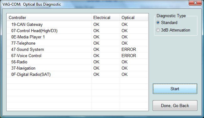

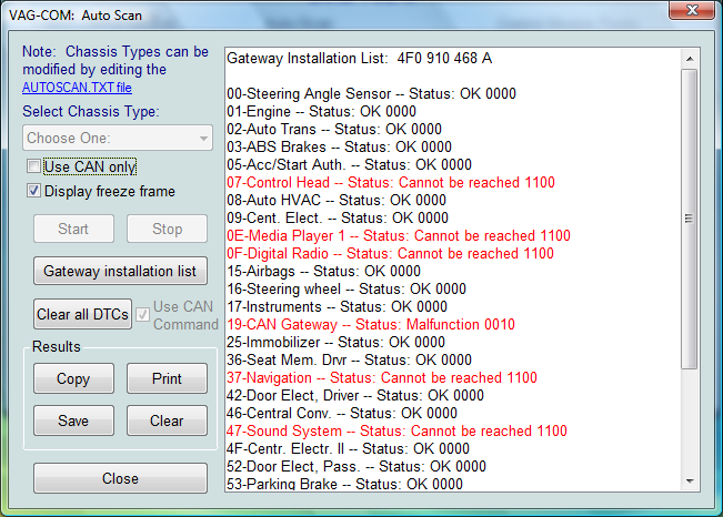

Optical Bus
Diagnostics.
On models with a
MOST bus, many control modules will be completely inaccessible
via conventional diagnostics if there's a break in the MOST bus.
Here's an example of an A6 with a break in the MOST bus:
Optical Bus Diagnostics (accessible from the Applications screen)
can isolate the source of the problem:
In this case, it's clear that the modules are all electrically OK,
but the Optical bus is broken between the Sound System module and
the Voice Control module.

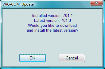

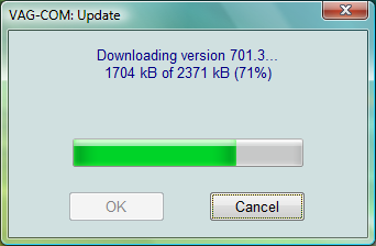

Automatic Updates.
If
an internet connection is available, VAG-COM will notify the user
when updates are available and will ask permission to download and
install updates:
Because we do not want to burden customers' PCs with a resource
hogging update scheduler, VAG-COM will only check for updates when
it is started and when the PC is rebooted. We've
tried to make this as unobtrusive as possible -- VAG-COM will not
complain if there's no internet connection available -- you just
won't get updates.
Note: Some 3rd-party firewall software may complain
that VAG-COM is trying to access the internet -- if this happens you
should either tell the firewall to allow it, or turn off Automatic
Updates on the Options screen (see below):

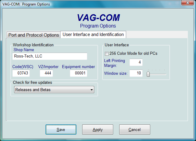

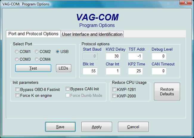

Revised, Tabbed Options screen:

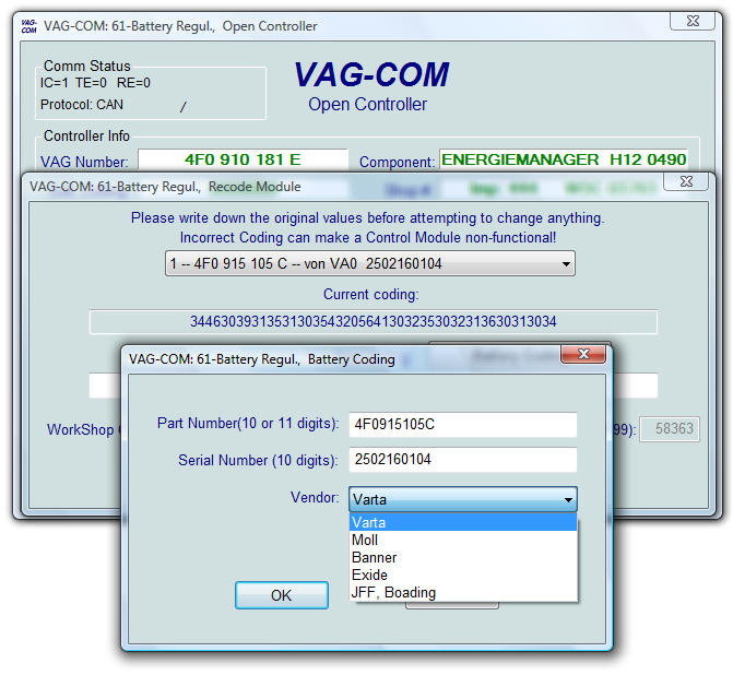

Battery Coding Assistant
For cars
which require a replacement battery to be coded in the 61-Battery
Regulation module we have added this function:

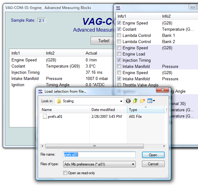

Enhancements to Advanced Measuring
Blocks
The Advanced Measuring Blocks now include a [ Turbo ] button and the ability to
save the list of selected items to a file and retrieve it later:

Default installation location is
C:\ROSS-TECH\VAG-COM-BETA.
