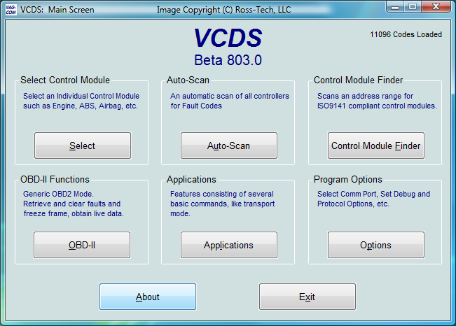

Beta 803 includes the following new features:
New Product Name: VAG-COM is now VCDS�.
Several years ago, we decided we really
should have a registered trademark for the name of our flagship
product. Unfortunately, we were not able to get VAG-COM registered
as a trademark in the USA, hence the name change.
At one point we
considered
FUV-COM as the new name but decided
VCDS had more continuity -- Vag Com Diagnostic
System. ;-)

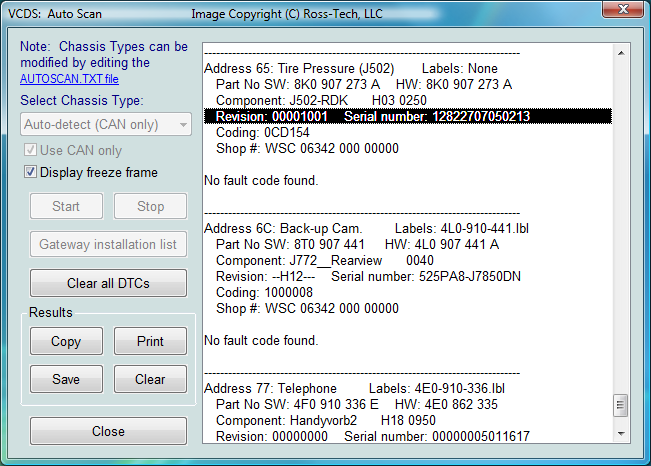

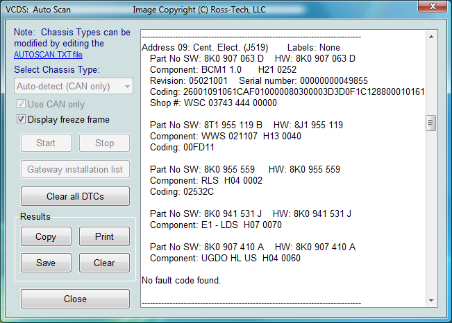

Auto-Scan now shows complete details
for Slave modules using new Service 22 ID methods:

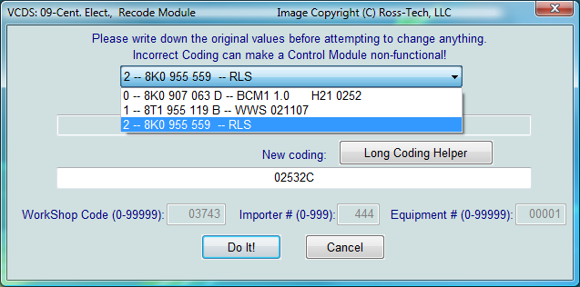

These modules can now be coded as
well:
AutoScan Results now include Control
Module Revision and Serial Number if the control module has
these available:

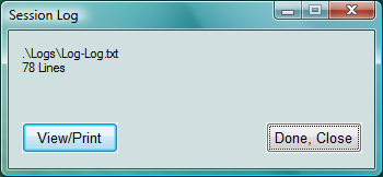

There are now [Save] buttons on
numerous screens which previously did not have them. Clicking
any [Save] button for the first time during a session will open a
Session Log file. A dialog will appear prompting the user for VIN
(which will be pre-filled if it has already been read from the car),
License Plate, Mileage (also pre-filled if VC has been able to read
it) and Repair Order Number. None of this data is required, but the
name of the Session Log file will be based on the data available.
Once the Session Log is open, a new small window will open and
remain on the screen until it is explicitly closed or you exit VC:
Subsequent clicks of the [Save] button will add the new data to the
same file. This allows the user to create a single log file from
various different screens in VC.

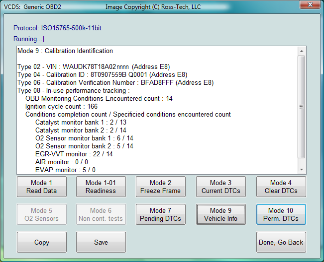

Support for Generic OBD-II Mode 10
(Permanent DTCs) and many new PIDs defined in SAE Standard J1979
Revision 2007-05. Added [Copy] and [Save] buttons to OBD-II screen:

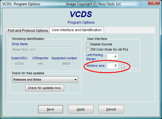

Ability to reduce the Window Size to
from the previous minimum of 10 to 8. We are at the point where
we need more space on some screens (for example the OBD-II
functions) and making a smaller size available will retain
compatibility for people using machines with screens as small as
640x480.

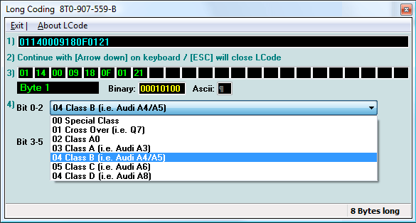

New Long Coding Helper.
Thanks to Niels Ezerman of
NE-Tech for this, and to
Sebastian for the updated label files.
