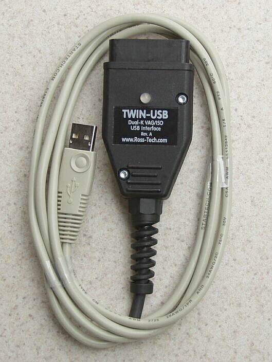

TWIN-USB
Dual-K  VAG/ISO <-> USB Communications Interface
Click for larger picture
  • USB connector plugs into most modern laptops!   (USB 1.1 or 2.0)
  • Fully automatic support of for dual-K lines found in "new" B6/8E chassis Audi A4 and 2002+ Audi A6 -- no VAS-6017 required -- no manual switches!
  • Fully backward compatible with most cars using a single K-line or K plus L (possible exception -- cars that that have their "Check Engine" light connected to the L-line).
  • Fully automatic protection against over-current conditions on both K1 and K2/L lines, no fuses required.
  • OBD-II connector made to our own specifications.  Fits even in the "tight" cars like '96 Audi A4's, '96/'97 Audi A6's and all  European B5 Passats and B5 Audi A4's.
  • Bi-Color (red/green) status/activity LED
  • 12 month guarantee against defects.
The car end of this interface is an OBD-II type connector which plugs right in to most 1994 and newer VW's and 1996 and newer Audis.   Most 1990-1995 Audis and 1990-1993 VW's have the "2x2" data link connector, click here for more info.
The cable on this adapter is about 6 feet long -- just right for most laptops.    You may be able to extend this interface another 6 to 10 feet with a USB extension cord, but we don't recommend or support it because the USB standard does not allow extension cords!   If you plan to use a desktop PC, please order a HEX-COM instead.
  • This interface requires a special driver to be installed on your PC.  It does not emulate a COM port.   That means this interface will not work with any other software besides VAG-COM.
  • We do not sell any interface adapters  as a "Stand-Alone" products.   We only sell them with our VAG-COM software.
