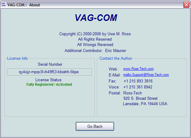

License Info:
  • The Serial Number will initially be �Please test on car before registering� until you have connected to a car and checked fault codes in a controller. After you have done this, you will have a Serial Number composed of letters and numbers.
  • License Status should always be Fully Registered / Activated, with all of our Current Interfaces since they store their own activation. With all other Interfaces, this will be "Unregistered/Shareware" until you Register/Activate VAG-COM.
On this screen, you will also find a Copyright Notice, License info, and Contact Information.   The Web and E-Mail "links" open up your browser or mail program, respectively and can be used if your PC is connected to the Internet.
To return to the Main Screen, click [Go Back].
