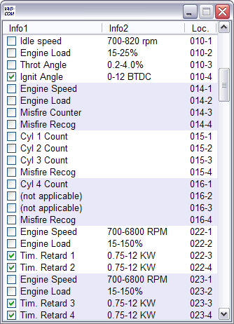

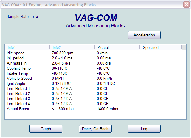

Measuring Blocks
This function expands on the
Measuring
Blocks function and lets you select up to 12 measuring values from as
many as 12 different groups from a selection dialog that shows the
contents of the measuring values. This function is available only when
a label file
exists for the control module being accessed.

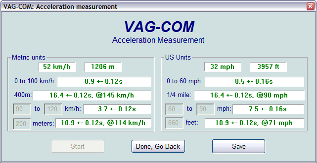

Acceleration Measurement
When you have one or more measuring group
with speed (km/h) in it, clicking on [Acceleration] will bring up
the Acceleration Measurement window, which allows you to enter start and
stop speeds and distances. After entering the values you want to
measure, click [Start] and do your testing. When complete, click
on [Save] to save a copy of your results to your C:\Program
Files\VAG-COM\Logs directory.
Sample Rate:
The frequency that the data is updated
is determined by the controller in the vehicle. Selecting a
greater number of different Groups will result in slower
sampling. This function does not currently support the
[Turbo Mode] that is found in Measuring Blocks when reading
Engine controllers that run KWP-2000.
