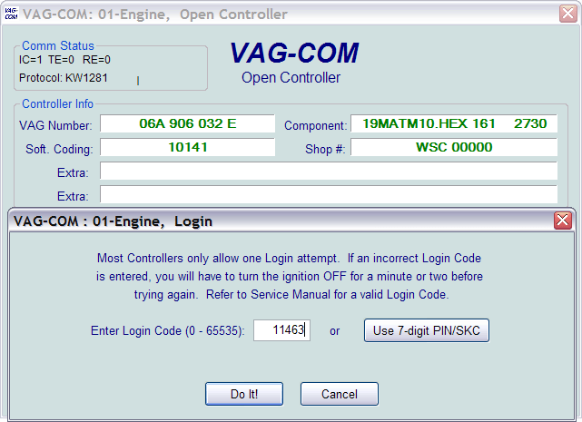

Corresponds to VAG 1551/1552 function 11
The Login Function must be used on some (but not all) Control Modules before you can Recode or change Adaptation values. On others, it "enables" certain features like cruise control. Valid Login codes can be found in the Factory Repair Manual for your car. If the label file for the controller contains suggestions, they may appear in a balloon.
If working on an Immobilizer, select [Use 7-digit PIN/SKC] to enter a 7-digit Secret Key Code.
Balloons: VAG-COM can show Login "charts" when appropriate information is available in a Label File for the control module in question. The balloon will appear when the mouse cursor is hovered over the Enter Login Code field.
Use the [Do It!] button to save the Login and return to the Select Function Screen.
Use the [Cancel] button to cancel the Login and return to the Select Function Screen.

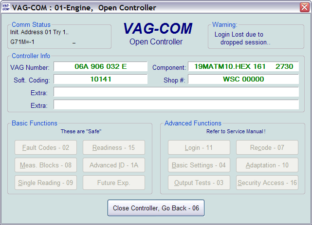

The following warning appears in the upper right corner of the screen if a session is disconnected after you have done a Login. You will need to do another Login.
Clickable Area Clickable Area Clickable Area Clickable Area Clickable Area Clickable Area Clickable Area Clickable Area Clickable Area Clickable Area Clickable Area Clickable Area
The most common cause of this is the use of an incorrect login code or a 7-digit PIN/SKC based on an incorrect Immobilizer ID or incorrect data entered in the 7-digit dialog.
