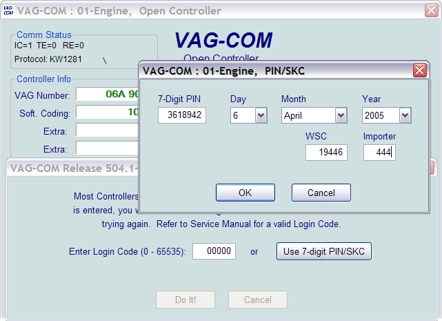

7-digit PIN/SKC Entry
The 7-digit PIN/SKC (Secret Key Code)
dialog is used for Key Matching and Immobilizer 3 Adaptation.
See this page for instructions for each procedure and immobilizer type:
Common Diagnostic
Procedures
You must enter the following
information:
7-digit SKC that the
dealer generated for your exact Immobilizer ID Number.
Date on which the 7-digit SKC
was GENERATED BY THE DEALER.
Workshop Code (WSC)
for the dealer that generated the SKC.
Importer Number for
The 7-digit SKC is useless without
the other three items.
When you have filled in
all of the data click [OK].
If any of the entered data does not make sense, the following message
may appear:
When you have successfully
submitted the 7-digit PIN/SKC, you are taken back to either the
Login or Adaptation screen (wherever you were when you clicked on [Use 7-digit PIN/SKC]
). Now, you should have �XXXXX� in Login or Adaptation
value.
Unlike the factory diagnostic
tools, with VAG-COM, the same PIN can be used for a particular car
at any time in the future, as long as you keep track of the PIN,
along with the Date on which the PIN was GENERATED BY THE
DEALER, the dealer's Workshop Code (WSC) and the Importer
number.
If you obtain a 7-digit SKC,
but the dealer has not provided the WSC, look at the window
stickers of vehicles on the dealer's lot. The dealer number will
be listed next to the name and address of the dealer. In the US,
the dealer number will be a 4 followed by five more digits, for
example 401742. To obtain the WSC, delete the 4 and simply use the
remaining five digits, 01742 in the above example.
The Importer number should be:
444 for all dealerships in the US
999 for all dealerships in Canada
995 for all dealerships in France
See this page for important SKC
information.
Use the
[OK] button to save
the 7-digit information and return to the Login or Adaptation
screen
Use the
[Cancel] button to
return to the Login or Adaptation screen without saving.
