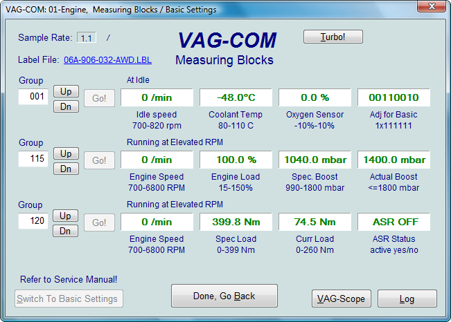

On this screen, you can read all sorts
of data from the Control Module in real-time.
Use
[Up] and [Dn]
to scroll through the available groups (000 - 255 on most Control
Modules). Don't become discouraged when you find some that say "ERROR:
Group xxx Not Available" or if you find some groups where the fields are
all blank. Most 1996 and newer ECU's have Groups through the 200 range, but
there are often "gaps" in the numbers.
You can also type a Group number
into the Group box and click [Go!]

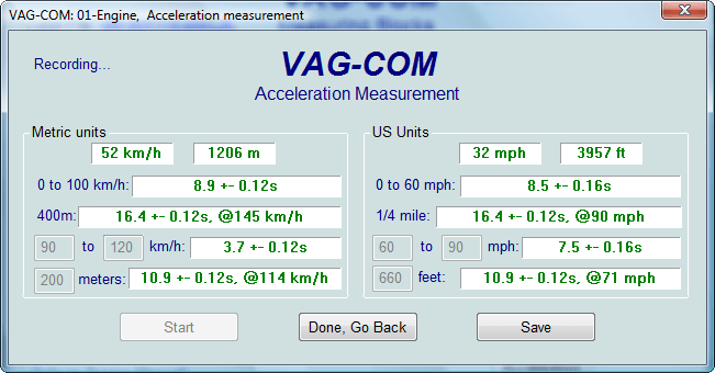

Acceleration Measurement
When you have one or more measuring group
with speed (km/h) in it, clicking on [Acceleration] will bring up
the Acceleration Measurement window, which allows you to enter start and
stop speeds and distances. After entering the values you want to
measure, click [Start] and do your testing. When complete, click
on [Save] to save a copy of your results to your C:\Program
Files\VAG-COM\Logs directory.

[Switch to
Basic Settings]
can be used to use the Basic Settings
function for
the Group that is currently being displayed. This should be done only
under guidance from the Service Manual or when following some other
documented procedure. For more information see the
Basic Settings page.
Multiple Groups are not permitted in Basic Settings. The
[Switch To Basic Settings]
button is intentionally disabled if you have groups "running" in the
second and third rows. To stop a running group, click on the box that
displays the group number (as though you wanted to enter a new number).
The button is also disabled on controllers using KWP-2000. On those, you
need to go directly to the Basic Settings screen.

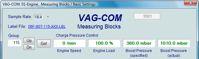

To reduce the confusion, VAG-COM
supports Label Files and will display the name of the Label File. The
Label File name is displayed on the top left when you are in Measuring
Blocks or Basic Settings. If you click on the name of the Label File,
the file will open in Notepad or whatever program you have set to handle
*LBL files. When a

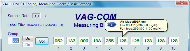

Group 000 supports special Labels. Due to
space constraints on the screen, these labels are displayed in a
"balloon" when the user clicks on a field:

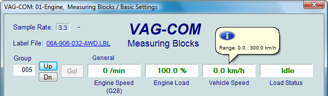

Label Files also allow a third label
field to be defined for each of the normal measuring block
fields. This label is displayed in a balloon when the user
clicks on the field. The idea is to put "specified values" in
this field:
