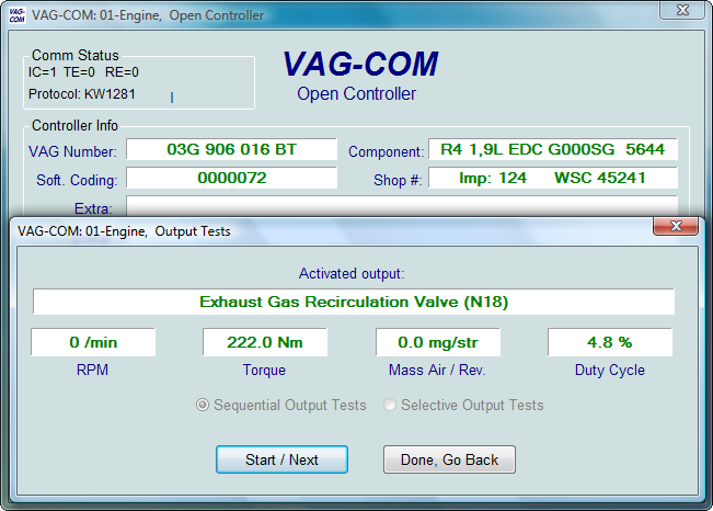

        To
        begin Output Tests, and to progress through each step, click
        [Start/Next].
The Outputs that can be tested and the sequence in which they become
        active is controlled strictly by the Control Module; this is not a
        function of the Diagnostic Tester.   To find out which Outputs can be
        tested and the sequence in which they will become active, please refer
        to the Factory Repair Manual for your car.
Once the Test Sequence once it has
        been started, clicking [Done, Go
        Back] will take you back to the Open Controller Function
        Screen.  The Test Sequence will still be active!

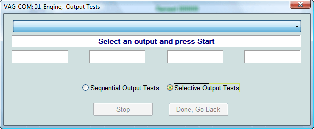

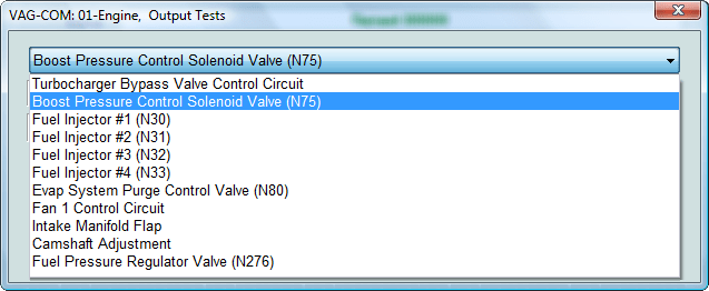

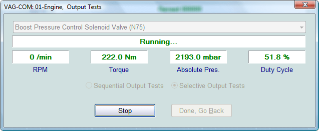

            Selective Output Tests.
             On those modules which support it, this is a more sophisticated version of the
			traditional (sequential) Output Test function.   It allows the user to select a particular output and activate
			it directly without going through a pre-defined sequence to get there.   Some modules have outputs which can
			only be tested this way.   Selective Output tests requires supporting data in a label file.
			There is no way to efficiently query a control module to find out which outputs are supported.

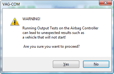

If you try to perform Output Tests
        on an Airbag controller, the following warning will pop up:
        For example, in the VW Touareg, a
        specific procedure must be
        performed to be able to start the vehicle if Output Tests on the Airbag
        Controller have been performed.
