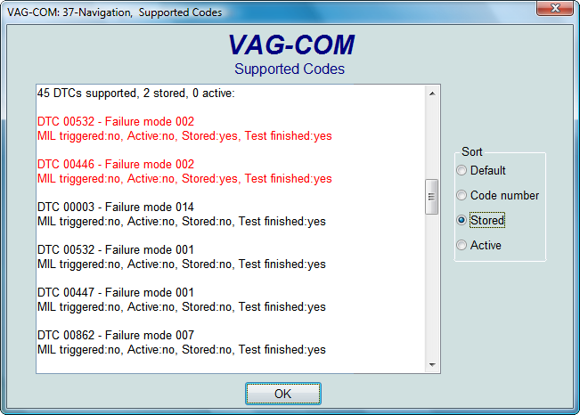

Corresponds to VAS 5051/5052 function 18
Supported Codes function.   On the latest control modules which have this capability, VAG-COM can show all DTC and Failure Mode combinations which a control module is capable of detecting, including the current status of each.
You can sort the results by selecting the radio buttons on the right side of the screen.
Use [OK] to return to the Controller Info / Select Function screen.
Note: On the Open Controller screen, the Supported Codes button will appear in place of the Single Reading function in modules that support it, since the two functions are mutually exclusive.
