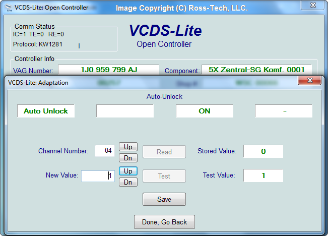

The Adaptation function allows you to alter certain values and/or settings in control modules which support it.
Warning
You should refer to the Factory Repair Manual for your particular car (or some other documented procedure) before "playing" with the Adaptation function.  However, many available Adaptation Channels are totally undocumented!
You can use the [Up] and [Dn] buttons next to Channel Number to scroll through all 99 possible channels, or you can manually enter a channel number and click [Read]If a channel exists, VCDS-Lite will show you the Stored Value.  If a channel does not exist, the Stored Value will show as "N/A".  Other data the controller may or may not send will be decoded and shown in the four display fields at the top of the screen.
Once you have reached a channel of interest, you can use the [Up] and [Dn] buttons next to New Value to incrementally change and test the value.   Or you can directly enter a New Value and click [Test].  This will tell the controller to temporarily use the new value so you can evaluate it's effects.
When you are satisfied with the effect of a New Value, you can store it in the Controller permanently by clicking [Save].
  • Channel 00 is a special case.  Performing a [Save] to Channel 00 resets all adaptation values to their original factory defaults. This only works in controllers that support this function, see your Factory Repair Manual to find out if this procedure applies to each controller in your vehicle.
  • Some Engine and Immobilizer controllers will require a valid Login before permitting you to [Test] or [Save] Adaptation values.
  • Values put in with [Test] but not Saved will persist until controller is powered-down.
Click [Done, Go Back] to return to the Open Controller Function Screen.
Label Files can support values and description for Adaptation channels.  This help chart is displayed in a balloon.
  • The Unregistered/Unactivated version of VCDS-Lite will only allow access to the first 9 Adaptation Channels (out of 99 possible).
  • The Save Function is Blocked.
  • Help charts are blocked.
