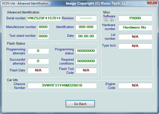

Corresponds to VAS-5051/5051 "Identification Services"
This function displays additional (and sometimes quite arcane) identifying data from the control module which does not fit on the Open Controller screen.
  • The Advanced ID function is only available in VERY FEW controllers using KWP-2000 and is not available on control modules using the old KW-1281 protocol.
  • The amount of data appearing on this screen will vary based on what the control module supports.
Use [Go Back] to return to the Open Controller screen.
