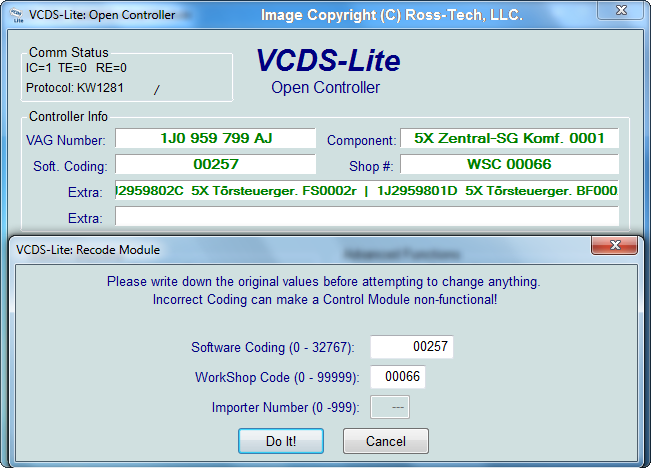

Recode or Coding is used to set various options in a Control Module.
Warning!
  • You should refer to the Factory Repair Manual for your particular car (or some other documented procedure) before attempting to Recode a Control Module.  At the very least, write down the original values.  There is no other way to "undo" or restore the original values if what you're trying to do doesn't work out.
  • Some Modules require a valid Login before you can re-code them.
  • A feature unique to VCDS-Lite: You can leave the Work Shop Code unchanged, or enter any workshop code you desire. Certain other programs always leave a tell-tale WSC when you re-code a module.
  • The Importer Number is only relevant for recoding controllers that use KWP-2000. By default, this will remain unchanged unless you have set up an Importer Number in the Options screen.
  • Up to 20 lines of coding chart data can be included in a Label File. This data is shown in a balloon on the coding screen (if VCDS-Lite is fully registered/activated). If there is a chart, it will pop up as a balloon when you click on the Software Coding field
Use the [Do It!] button in to save the new Soft Coding to the controller and return to the Open Controller Function screen.
Use the [Cancel] button to return to the Open Controller Function screen without saving.
  • Coding charts and suggestions are not available in Shareware.
