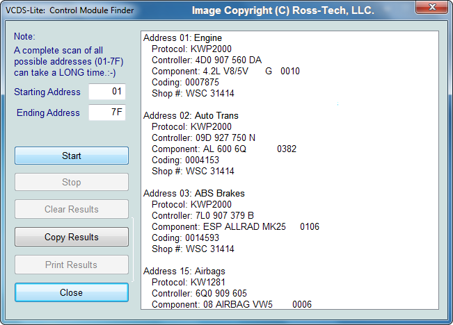

This function cycles through each possible address in the vehicle, finding each controller and reporting its Address, Name, Protocol, Controller VAG Number, Component Number, Soft. Coding, and Work Shop Code.
Note: No one car has all Modules!  Newer cars have more, older cars have fewer.
Starting Address lets you specify
[Start]
This begins the finder. Beware; a "full" scan can take 45 minutes or more. Of course, you can scan selected address ranges.
[Stop]
This stops the finder.
[Clear Results]
This erases your results.
Copy Results]
If you close the Finder dialog, any data in its output box will be lost. If you would like to keep a record, click the [Copy Results] button first, then you can then paste the results into the application of your choice, such as MS Word or Notepad.
[Print Results]
This sends the results to your printer
To return to the Main Screen, click [Close]
