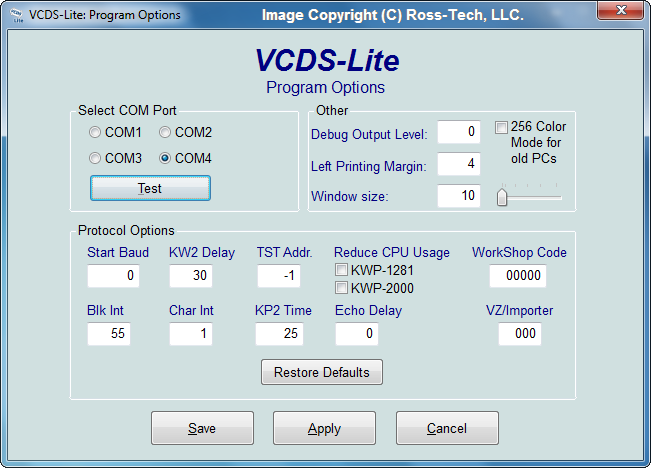

On this screen you can set a number of
Options.
Select Com
Port
Set the
COM Port to which you have connected the Interface
Adapter.
You can then click
[Test] to see if VCDS-Lite can find the adapter.
Other
Debug Level
controls how much debugging information VCDS-Lite records.
A zero in this field (the default) means NO debug output
will be generated whatsoever. This should decrease
VCDS-Lite's susceptibility to interference by things like
virus scanners (except when logging data). There should be
no reason to set Debug to anything other than zero unless
you are instructed to do so by Ross-Tech.
256
Color Mode for old PC's
This
display mode changes the background color from blue to
white, and looks better on some older monitors. The change
will take effect after you close and restart VCDS-Lite.
Left Margin Printing
This is
the number of spaces that printed pages are shifted to the
right.
Window Size
This
function allows you to change the apparent size of the
VCDS-Lite window on your screen. To see the
resizing take effect, click Save, then close VCDS-Lite.
When you restart, the new window size should be shown. Adjust this in small
increments since it is possible to make VCDS-Lite so large
that it is much bigger than your screen! If that happens delete this file from your PC: C:\Ross-Tech\VCDS-Lite\VCDS.CFG
You'll then need to Test and Save again.
Protocol Options
Start
Baud
is the first baud rate that VCDS-Lite will
try when connecting to a controller. The current default
value is 0. This means VCDS-Lite will determine the
correct start baud on its own. With our current
Interfaces, this field is unavailable.
KW2 Delay
has to do with the amount of time used
during the initialization of a session between the PC and
the car. The current default value is 30. Do not change
this value from the default unless you are
having difficulties communicating with a particular
controller. Contact us for advice if you are.
TST Addr.
has to do with the packet addresses used by
KWP-2000. The current default value is -1. Do not change
Debug Level
Reduce
CPU Usage checkboxes will greatly increase
responsiveness of other apps running at the same time as
VCDS-Lite. The disadvantage is somewhat reduced sample
rate.
KWP-1281:
The default value is unchecked. This reduces CPU usage
when connected to controllers using KWP-1281. Using this
feature *may* make the session with some control modules
unreliable.
KWP-2000:
when connected to controllers using KWP-2000
Blk Int
affects the protocol timing. The current
default value is 55. To get the highest sample rate
possible in the Measuring
Blocks screen,
set this to 25. Note, however, that this may cause
unreliable communications with some controllers.
Char lnt
also affects the protocol
timing. The current default value is 1. To get the highest
sample rate possible in the Measuring Blocks screen, set
this to 0. Note, however, that this may cause unreliable
KP2
Time only applies to controllers using the KWP-2000
protocol. The current default value is 25. Decreasing it
increases the sample rate in Measuring Blocks on control
modules that use the KWP-2000 protocols. The default value
should be safe for all applications, but if it's not, you
can always increase it again (to a maximum of 99).
Echo
Delay
The
WorkShop Code (known as the WSC) is found on the
Admin screen of a dealer's VAS-5051, as well as on the
dealer's stamp. The default value is 00000. For example,
using the stamp below, the dealer's number is 401/742. To
derive the Work Shop Code, drop the first digit and use the
remaining digits in order. If you are an
individual user or independent mechanic, just leave the
WorkShop Code set to "00000". This allows VCDS-Lite to
operate in �stealth� mode, keeping whatever WSC that was
already in the controller. If you are using VCDS-Lite at a
Dealership, enter your Dealer's Workshop Code. The Work Shop
Code is not easily changed once set on this screen. Contact
us for advice if you need to do so.
The
VZ/Importer number is essentially a "region code"
extension to the Work Shop Code (should be 444 for US, 999
for Canada). The default value is 000.
If you are an individual user or independent mechanic,
just leave the VZ/Importer number set to "000". This allows
VCDS-Lite to operate in �stealth� mode, keeping Importer
number that was already in the controller. If you are using
VCDS-Lite at a Dealership, enter your Dealer's VZ/Importer
number. The VZ/Importer number is not easily changed once
set on this screen. Contact us for advice if you need to do
so.
