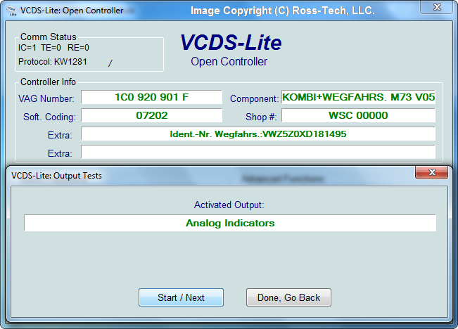

To begin
Output Tests, and to progress through each step, click
[Start/Next]. In some cases an
[Activate] button will appear, depending on the specifics of
the control module.

Once the
Test Sequence once it has been started, clicking
[Done, Go
Back] will take you back to the Open Controller
Function Screen. The Test Sequence will still be
active!
