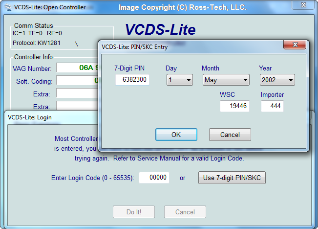

The 7-digit PIN/SKC (Secret Key Code) dialog is used for Key Matching and Immobilizer 3 Adaptation.
See this page for instructions for each procedure and immobilizer type: Common Diagnostic Procedures
Important Note: Unless you ALREADY have the SKC information for your vehicle and components then you will NOT be able to do any of the Immobilizer functions.
Click this link for more information.
You must enter the following information:
  • 7-digit SKC that the dealer generated for your exact Immobilizer ID Number.
  • Date on which the 7-digit SKC was GENERATED BY THE DEALER
  • Workshop Code (WSC) for the dealer that generated the SKC.
  • Importer Number for the dealer that generated the SKC.
The 7-digit SKC is useless without the other three items.
When you have filled in all of the data click [OK]. If any of the entered data does not make sense, the following message may appear:
When you have successfully submitted the 7-digit PIN/SKC, you are taken back to either the Login or Adaptation screen (wherever you were when you clicked on [Use 7-digit PIN/SKC] ). Now, you should have �XXXXX� in Login or Adaptation value.
  • Unlike the factory diagnostic tools, with VCDS-Lite, the same PIN can be used for a particular car at any time in the future, as long as you keep track of the PIN, along with the Date on which the PIN was GENERATED BY THE DEALER, the dealer's Workshop Code (WSC) and the Importer number.
