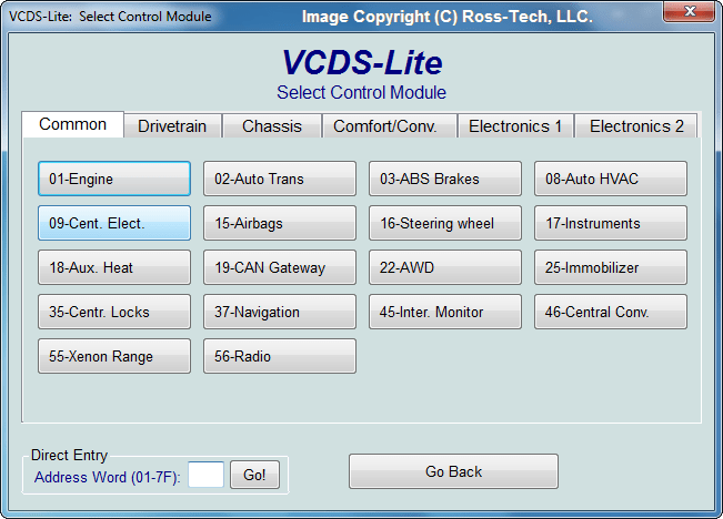

The various computers in the car are called �Control Modules� or "Controllers". On this screen, you select which Control Module you want to "talk" to. Note: Your car will not have all the Control Modules listed in VCDS-Lite, only the ones on the Applications Page for your car.   Newer cars have more, older cars have fewer.
Each tab on the top of this screen contains a number of different controllers grouped by category: Common, Drivetrain, Chassis, Comfort/Conv, Electronics 1, and Electronics 2.
Each possible controller is listed as a number and a description, i.e., [01-Engine]. The number corresponds to the controller number that you'd find in your Factory Repair Manual in the instructions for using a VAG-1551 or other factory diagnostic tool.
To establish communications with a particular Control Module, simply click on the appropriate button.
Direct Entry
You can also enter any address manually.  Simply put in the address such as 01 and click [Go!]
To return to the Main Screen, click [Go Back]
In this demo, any Controller you click will take you to the Engine controller. Examples screens for functions may be from various different Controllers (Engine, Airbags, Instruments).
