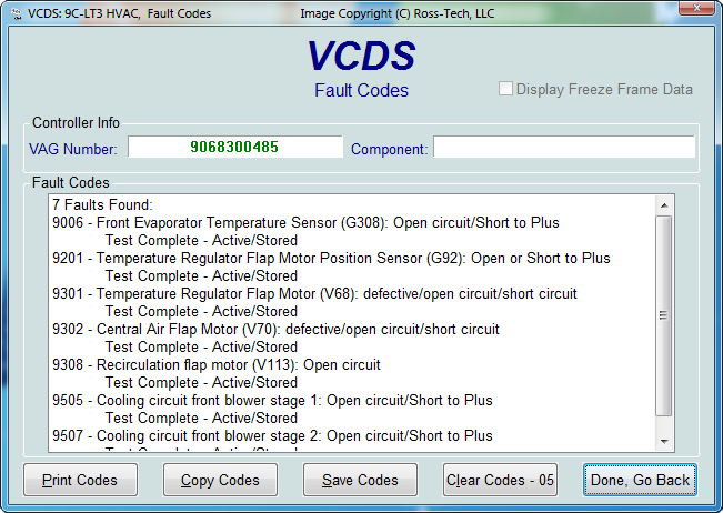

Communications with all control
modules in VW Crafter ("LT3") light trucks.
To access Crafter modules individually, click the new "LT3" tab on the Select Control Module screen:
Support for reading and clearing DTCs (fault codes) in all control modules in VW Crafter light trucks.

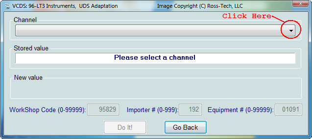

Now click [Adaptation] which will produce the usual UDS
Adaptation screen:

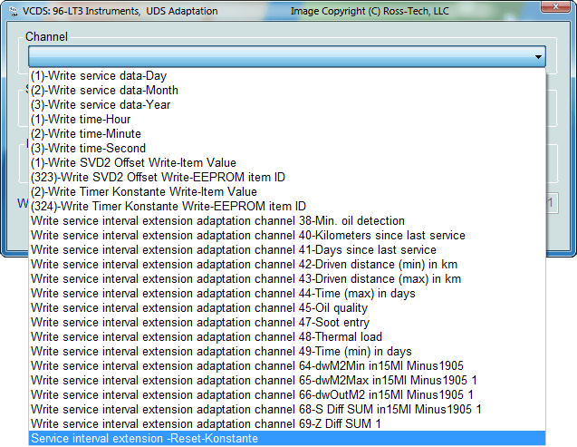

On this screen, click the down-arrow in drop-down box labeled "Channel"
and then select "Service interval extension - Reset Konstante".
The precise name of this channel may vary depending on exact
instrument cluster installed in the vehicle, but the correct channel
should not be hard to find:

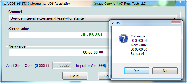

Once you've selected the channel, the Stored value should be
four bytes of hexadecimal data. If the Service Reminder is ON,
these will usually (but not always) be "00 00 00 01".
To reset the Service Reminder, type in a New Value of "00 00 00 00",
and click [Do It!]. After that, you'll have to confirm
that you really want to do this:

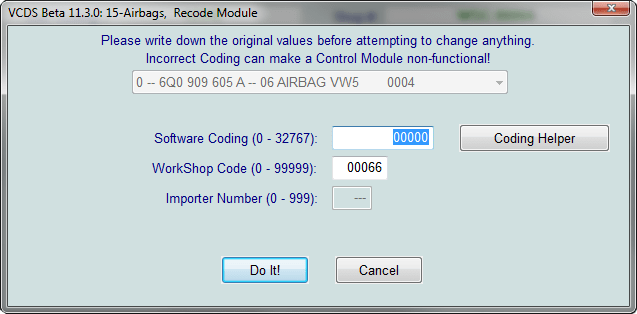

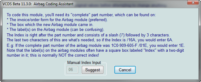

New, more universal Airbag Coding
Assistant. Works with the latest airbags which use
Index-Based coding and provides tips where to find the Index.

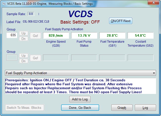

Added an area to display additional info for Basic Settings.
The data to be displayed in this area comes from the Label files and it may take some time
before tips are included for most Basic Settings groups.

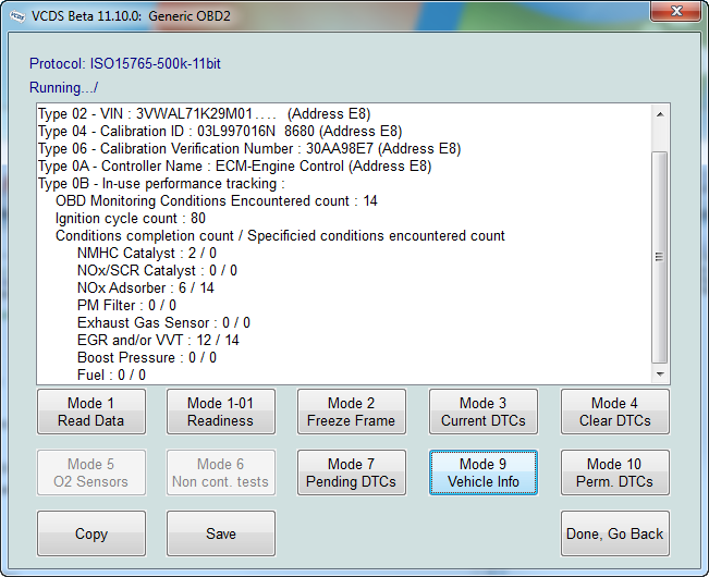

Added data types 0B, 0D, 0F to
Generic OBD-II Mode 9.
Fixed some bugs in the display of certain high-numbered, rarely used PIDs.
