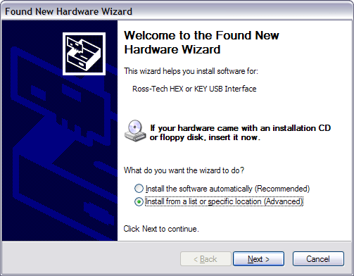

The
New Hardware Found Wizard should appear:
On the screen above, select "Install from a list or
specific location (Advanced)"
then click the [Next >] button.

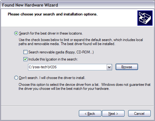

On the screen
above:
Select "Search for the best
driver in these locations"

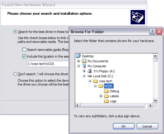

Check "Include this location in the search:"
Use the [Browse] button to find the VCDS folder
(Usually C:\ross-tech\VCDS\
unless you chose a different
folder when you installed the software)
Click [OK]
The following dialog should appear:
Click

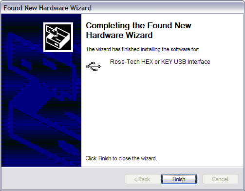

Click
the [Finish] button to complete the installation.

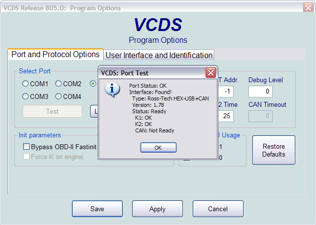

Start
VCDS.
Click the [Options] button.
In the "Select COM Port" box, select USB.
Click the [Test] button.
The results should look like this (it may have
additional information in the Port Test dialog).
Click [OK] and click [Save]
