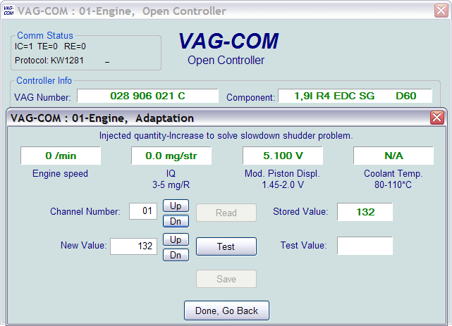

You can use the [Up] and [Dn] buttons next to Channel Number to scroll through all 99 possible channels, or you can manually enter a channel number and click [Read]If a channel exists, VAG-COM will show you the Stored Value.  If a channel does not exist, the Stored Value will show as "N/A".  Other data the controller may or may not send will be decoded and shown in the four display fields at the top of the screen.
Once you have reached a channel of interest, you can use the [Up] and [Dn] buttons next to New Value to incrementally change and test the value.   Or you can directly enter a New Value and click [Test].  This will tell the controller to temporarily use the new value so you can evaluate it's effects.
When you are satisfied with the effect of a New Value, you can store it in the Controller permanently by clicking [Save].

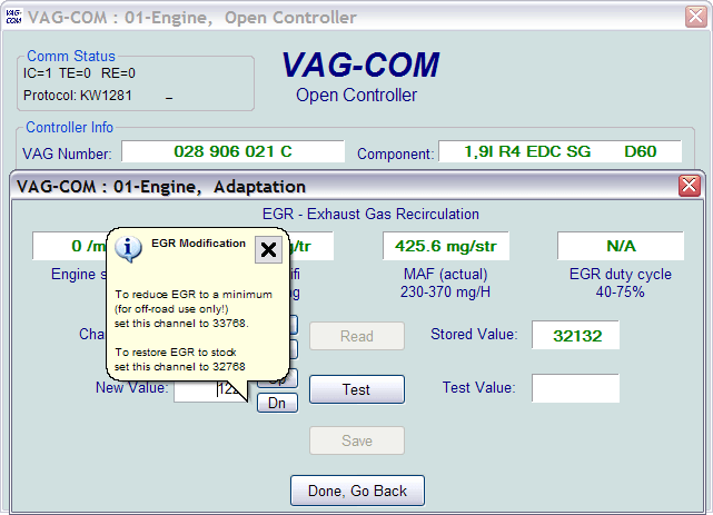

Long Adaptations.  Used/needed (for example) to balance the fuel injectors on Common-Rail TDI engines such as the BKN.
As of version 404.0, Label Files can support values and description for Adaptation channels.  This help chart is displayed in a balloon:
