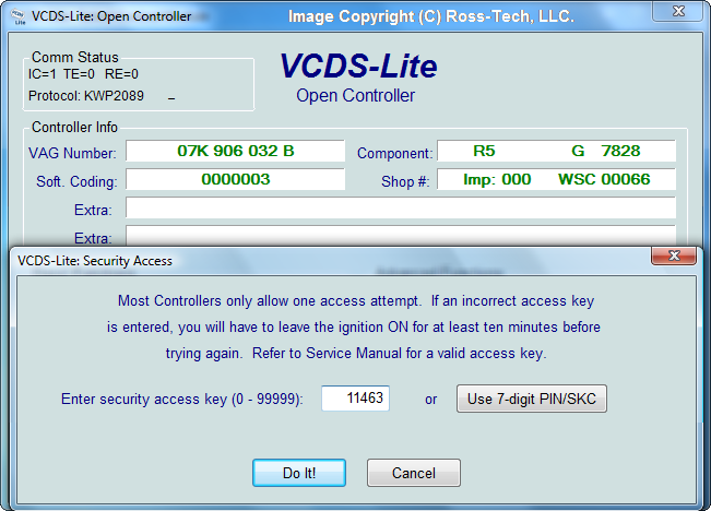

Corresponds to VAG 1551/2 Function 16, (KWP-2000 only)
The Security Access Function must be used on some (but not all) KWP-2000 Control Modules before you can Recode or change Adaptation values. On others, it "enables" certain features like cruise control. Valid Login codes can be found in the Factory Repair Manual for your car.
The Security Access Function supports 7-Digit SKCs.   This is needed for Immobilizer Functions (such as key programming) on the some vehicles as discussed on the Immobilizer Page.
Use the [Do It!] button to save the Login and return to the Select Function Screen.
Use the [Cancel] button to cancel the Login and return to the Select Function Screen.
