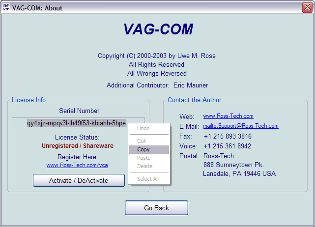

Finding and Copying your
Serial Number:
Go to the About screen of VAG-COM, where you will find the Serial Number.
Highlight the Serial Number by double-clicking it with your mouse. Then, right-click the highlighted area and select Copy.
This will copy your Serial Number into Windows Clipboard, so you can paste it somewhere else.

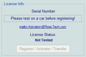

If you do not see a Serial Number, but
instead see a message that says:
... then you need to TEST VAG-COM
as described in our FAQ. Submitting your Registration

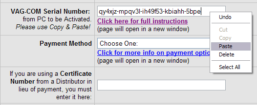

Go to our appropriate
registration
form and and find the field for "VAG-COM Serial Number:"
Right-click on the white area and select Paste to paste the Serial
Number into the appropriate area. Fill out the remainder of the
form and submit it.

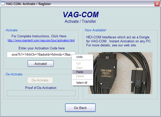

Entering the Activation
Code
Once you receive your Activation Code, go to the
Register/Activate/Transfer Screen in VAG-COM. Enter the Activation
Code and click the [ Activate!
] button.
Again, please use
Copy and Paste to avoid
errors when entering your Activation Code.

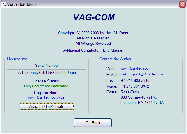

Verifying the
Activation
Once you have entered a valid Activation
Code, the Activation Code field should be disabled and say "Already Activated".
When you return to the About screen, the "License Status"
should read "Fully Registered/Activated" like this:
