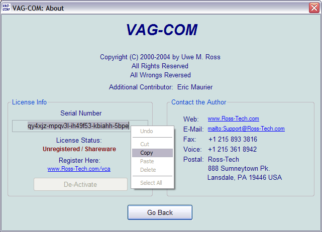

Finding and Copying your
Serial Number:
Go to the About screen of VAG-COM, where you will find the Serial Number.
Highlight the Serial Number by double-clicking it with your mouse. Then, right-click the highlighted area and select Copy.
This will copy your Serial Number into Windows Clipboard, so you can paste it somewhere else.

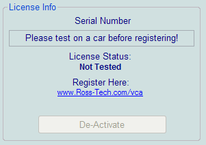

If you do not see a Serial Number, but
instead see a message that says:
... then you need to TEST VAG-COM
as described in our FAQ. Submitting your Registration

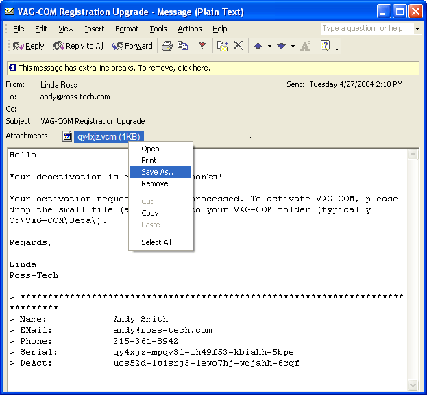

Saving the Activation File
Once you receive the email with Activation File, make sure that the
Serial Number in the email still matches the Serial Number as shown on
the About Screen in VAG-COM. Use your email program to save the

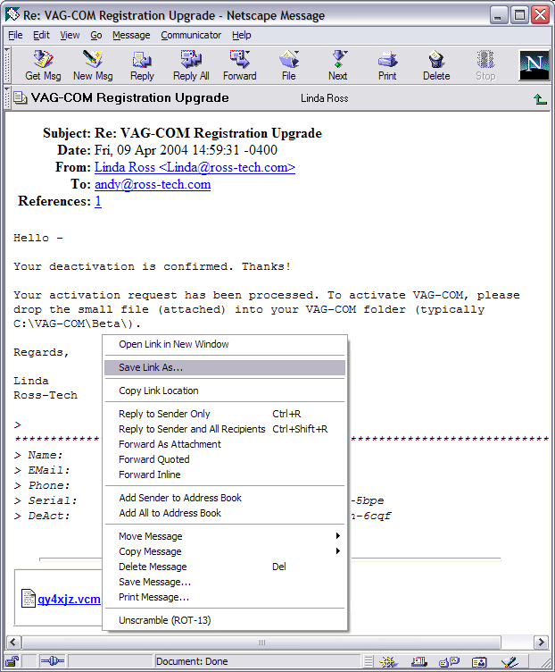

attachment as shown in the examples below. If your email program does
not display the file as an attachment (may happen with Hotmail
accounts), reply to the email and ask for further instructions.
- OR -

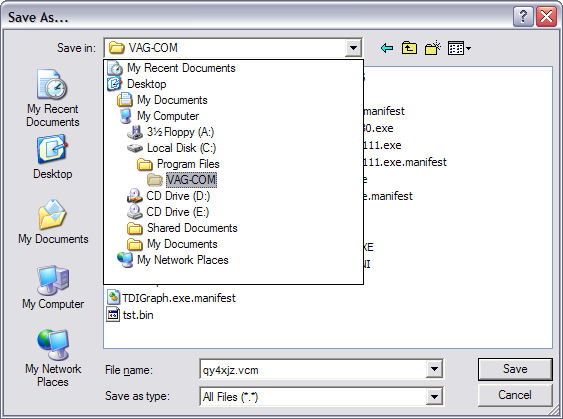

Save the attached
Activation file to your C:\Program
Files\VAG-COM folder as shown below:
(Make sure the "Save as type:" field at the bottom shows "All
Files (*.*)"
(The above examples use
Netscape Messenger and Microsoft Outlook email programs. Consult the
documentation for your email program for assistance with saving
attachments)

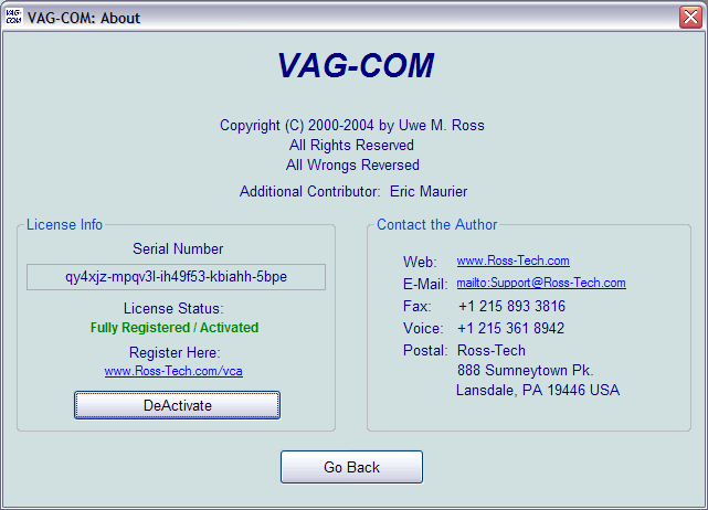

Verifying the
Activation
When you return to the About screen, the "License Status"
should read "Fully Registered/Activated" like this:
