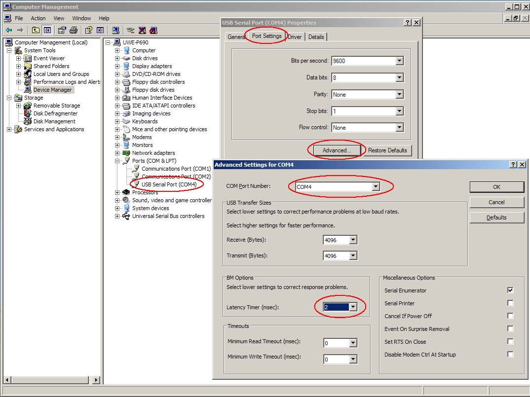

If you're considering VCDS-Lite, then you obviously have a very limited budget for tools and we can't compete on price with Chinese eBay sellers. When choosing an interface for VCDS-Lite, we recommend getting one that's based on an FTDI FT232 Chip. They almost always work well if you manually configure the virtual COM port into an unused port in the range of COM1 - COM4 and set the latency timer to 2, as shown here.
