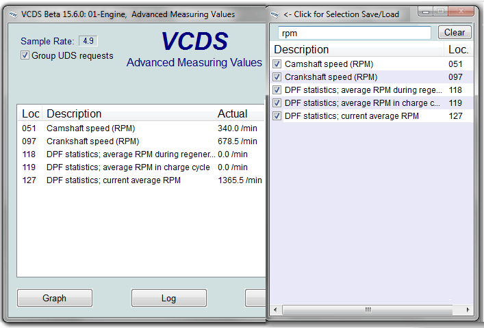

New filtering capabilities in
Advanced Measuring Values Very intuitive to use; just type a term in the box in the selection dialog:

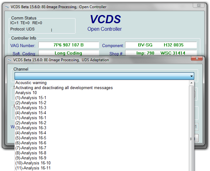

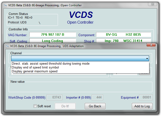

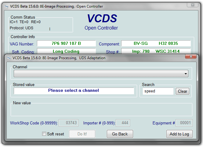

Fixed bugs in UDS Adaptation Search function
and dramatically improved loading speed for modules with thousands of channels.
