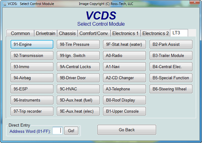

To access Crafter modules individually, click the new "LT3" tab on the Select Control Module screen:

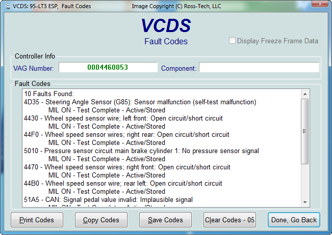

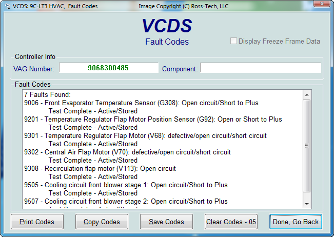

VCDS allows you to read and clear
(fault codes) in all control modules in VW Crafter light trucks:

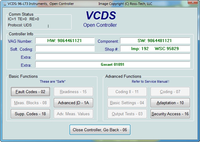

To reset SRI in a Crafter, click the LT3 tab in the Select Control
Module Screen, then click [96 - Instruments] and you'll get to a
screen like this:

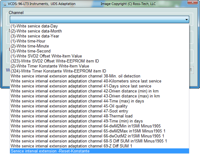

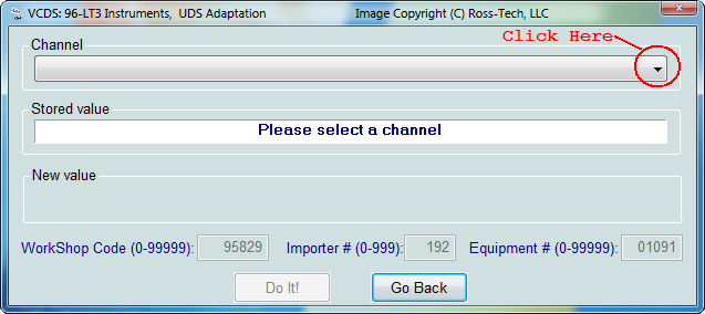

Now click [Adaptation] which will produce the usual UDS
Adaptation screen:
On this screen, click the down-arrow in drop-down box labeled "Channel"
and then select "Service interval extension - Reset Konstante".
The precise name of this channel may vary depending on exact
instrument cluster installed in the vehicle, but the correct channel
should not be hard to find:

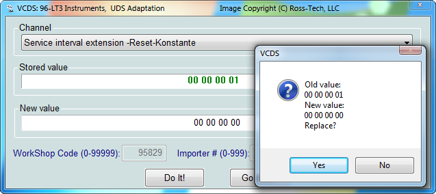

Once you've selected the channel, the Stored value should be
four bytes of hexadecimal data. If the Service Reminder is ON,
these will usually (but not always) be "00 00 00 01".
To reset the Service Reminder, type in a New Value of "00 00 00 00",
and click [Do It!]. After that, you'll have to confirm
that you really want to do this:
We strongly urge customers not to to alter Adaptation channels
unless they understand the contents of a particular channel.
