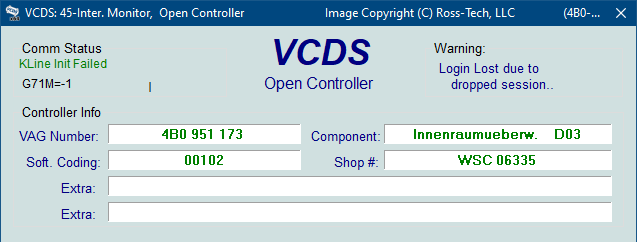

The following warning appears in the upper right corner of the screen if a session is disconnected after you have done a Login. You will need to exit the Controller do another Login.
The most common cause of this is the use of an incorrect login code or a 7-digit PIN/SKC based on an incorrect Immobilizer ID or incorrect data entered in the 7-digit dialog.
