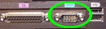

If you're using a PC running an older version of Windows or with a CPU speed of less than 1GHz, we recommend a Serial interface. Obviously a serial interface requires a Serial Port which looks like this:
correct serial portincorrect port
Observe the port we surrounded with the GREEN oval. Notice the 9 male pins? That's a Serial port. Observe the port circled and crossed in RED. Notice the 15 female pins? That is a Monitor port and will not work!
