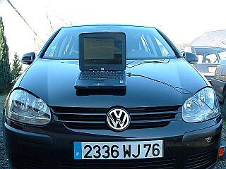

A 1K Chassis Golf-5 connected
using a prototype HEX-USB+CAN Interface -- February 2004
