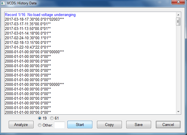

Battery History Data
... on cars that support it, VCDS can now read and display the
Battery History Data. This can help evaluate the condition of
a car's battery and aids in trouble-shooting charging system and battery issues.
The function is accessible via a button on the Applications screen.
The user must then select the module that the history data is to be
read from. It will be either 61 or 19 depending on the model of car.

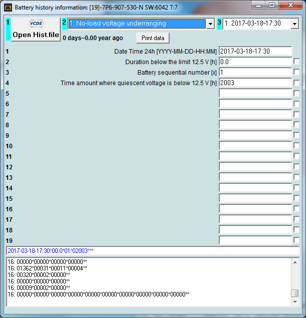

The ability to analyze the
above History Data via Niels Ezerman's excellent add-on.
... just click the [Analyze] button on the above screen and
VCDS will launch it for an more understandable view of the
data:
Use the drop-down boxes labeled 2 and 3 at the top of the dialog to
select different items of history data to view.

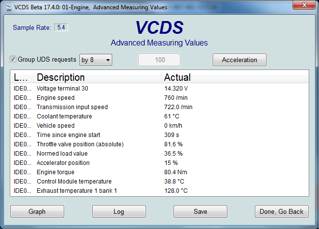

Beta 17.4.0 Added:
The ability to split Grouped UDS requests in Advanced Measuring Values.
... for faster sample rates when viewing or logging many items.
Note that this
improvement is only available with current generation (HEX-NET and HEX-V2) interfaces.
