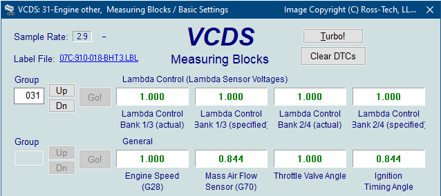

Dual ECUs: For vehicles with dual ECU's (like the Audi R8), data from both ECU's can be viewed simultaneously by accessing [31-Engine Other] as shown here:
screenshot of the VCDS dual measuring blocks screen

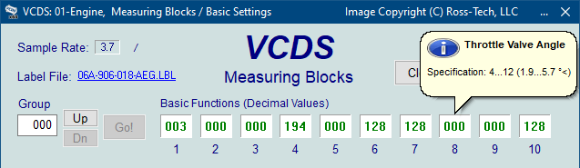

Group 000 supports special Labels. Due to space constraints on the screen, these labels are displayed in a "balloon" when the user hovers over a field:

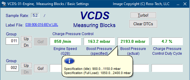

Label Files also allow a third label field to be defined for each of the normal measuring block fields. This label is displayed in a balloon when the user hovers over a field. The idea is to put "specified values" in this field:
