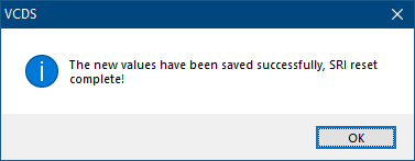

Upon clicking [Perform SRI] the new values will be stored in the (often less than intuitive) sequence required. After cycling the ignition, the cluster should no longer indicate that service is due.
Screenshot of VCDS SRI complete
