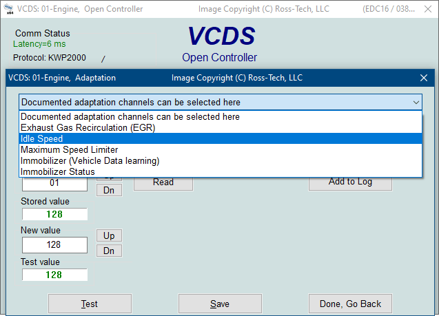

Label Files can support values and descriptions for Adaptation channels. A help chart may be displayed in a balloon. For control modules that have a Label File with Adaptation information, a drop-down menu may also be available, which allows you to select from the supported functions:

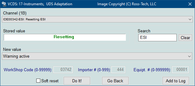

UDS: For controllers using the UDS/ODX/ASAM protocol, the drop-down menu MUST be used, since traditional Adaptation Channels do not apply. The naming of each channel should coincide with factory identifiers for various data objects like IDEnnnnn. The Search box can be used to filter the Channel pulldown to display only those items that contain your search term. The [Clear] button will reset the search box. VCDS supports Adaptation for all control modules in the VW Crafter / LT3 as explained here. In Adaptation for UDS controllers, WSC, Importer, and Equipment numbers can be entered if needed by the controller.
Soft reset can be checked to prompt the control module to "reboot" itself after the change has been made. In some cases this (or cycling the ignition) is needed in certain UDS modules before changes take effect.

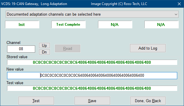

Long Adaptation is a subset of the Adaptation function and is used/needed (for example) to balance the fuel injectors on Common-Rail TDI engines (such as the BKN). It is also used in the CAN Gateway of new vehicles like the A5 as shown here:

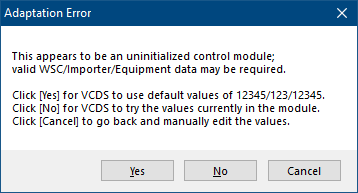

If an uninitialized control module warning appears, this means that one or more of the WorkShop Code, Importer, or Equipment numbers are all zeros. Since some modules will not allow you to Save Adaptation values unless non-zero numbers are in any or all of those fields, VCDS shows you this error when it thinks this might be the case.. In most cases you should click [Yes] to allow VCDS to enter 12345/123/12345 in those fields. If you click [No] then VCDS will try using the values currently stored in the module even if they are all zeros. If you click [Cancel] then VCDS will allow you to manually type in values for each of those fields.
